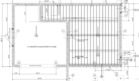

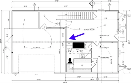

Is the first floor partially under ground? I dont see a way to provide for an OAK. Might be something to consider before construction being new and probably fairly airtight.
Outside Air Kit. Is the first floor on a slab?
Crawlspace? The garage is obviously on concrete. I dont see a step up. Your plans are a little unorthodox to what Im accustomed.

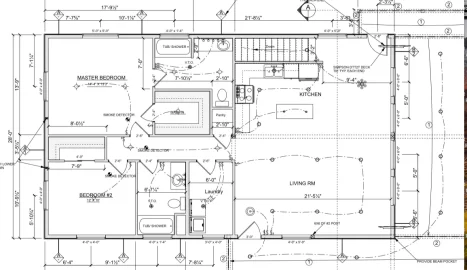

Do you have a front elevation in your plans?
OAK should be no problem should you choose to use one. So you will have a deck around the upper floor?
