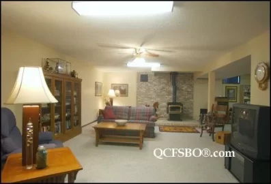

I am purchasing a home in DeWitt Iowa (15 miles north of the Quad Cities) in July that has a wood stove in it. The owners are taking it with them and giving me some money towards the purchase of a new one. They have a 20 year old stove that I am sure will not be as efficient a new one I will purchase and was wondering about a proper sized stove. The house is 1250 sqft on the main level and 1000 square feet finished in the basement. The stove is in the basement in about a family room about 30x15 which has an open office next to it at 15x12 and a bedroom with a door adjacent to it at 16x12 (where the picture is taken from). They put a cold air return right above the stove and use the fan on the Heating system to heat the whole house. My wife and I really like the HearthStone Heritage and Bennington, but are unsure of the size that would be right. We want to heat the whole house but still want to be able to be in the basement at a comfortabe temp (not too hot!). I have attached pictures of the outside of the house and the basement to give a better idea of what I am talking about.

Cory, sounds like you're on track with a soapstone stove....it should meet your criteria in the sense that it won't burn you out of the basement like cast-iron or steel might.As for sizing a unit for your space, I believe the Mansfield is overkill but the Heritage oughta be a good match for your sq. footage.The soapstone folks will likely chime in soon as well;you'll have a sea of suggestions and info to swim in.Bon chance!
A sopastone stove will look very nice in there.ow do you intend to use it? Round the clock or evenings and weekends?
Ask the current owners what stove they have and how it worked out. That's probably a good guide as to size.
I have never had a wood stove, so I guess I am not sure how we will end up using it, would like to use it to heat the house. I dont want to pay the gas man anymore. I did ask the owners about the size of stove they had and they were unsure. They did say that it gets hot enough downstairs to make it uncomfortable.

You are probably on the right track in terms of thinking about soapstone, but I'm concerned about the cold air return over the stove you mentioned in the quote that I bolded - There are two issues, one performance, the other safety...
1. Performance - unless the entire HVAC system is in the heated space, including all the duct work, you may not get as good performance as you might think. A typical forced air system has fairly high heat losses going through the ducts, and by the time the heat gets sucked in, and blown throughout the system it may not be that much help... A furnace works in an HVAC system because the heat exchanger is MUCH hotter than what you are going to get off the stove.
2. Safety - Code generally prohibits a cold air return w/in 10 feet of a wood burning appliance, it is considered very dangerous to put one closer, especially over a stove. The reason is that if the stove malfunctions in any way, either by leaking fumes, or having a fire start, the return can rapidly spread smoke or toxic fumes throughout the house, including into the sleeping areas, possibly before a warning alarm was triggered. I would want to have the installation looked at very closely by a competent inspector (note that not all gov't inspectors are...) before purchasing the home, or possibly before running a stove in that location.
One of our members, Elk, (who seems to be taking the summer off,) is a very competent building inspector, if he sees this I am sure he could tell you better than I about the problems with the setup as you are describing it.
