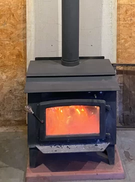

Does anyone know the brand of stove this is? In Canada, not having a Certification label deems a wood burning appliance uncertified. This appliance has it's serial number intake but I have not been able to confirm which brand it is, in order to confirm possible clearances. If I can confirm the brand I can make a note of it and leave it up to the insurance company to decide. Thank you

Looks like it may be a Century S244. The firebrick pattern and baffle design may help with verification.

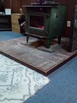

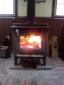

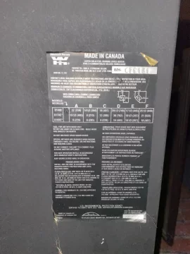

it actually looks identical to my stove. Mine is a 1991 Haughs Campbell Elite S14XE
Which was bought by Century, Correct?

The clearances for the S244 are shorter than for the Haugh S14XE in spite of the family resemblance. It's going to take a more detailed inspection of the stove to determine possible make and model. Unfortunately, I don't have any Haugh manuals to help.

Stepped/split top and tapered ash lip are not 244. Otherwise very similar appearance/size.

Thanks, this definitely looks like it. Can you take a frontal photo of the stove for me and give me the dimensions. I can make note of them in my WETT inspection report along with the existing serial number. It will be up to the insurance company to accept the stove or the client may adapt the installation clearances to 36" for an uncertified stove.

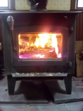

Sure, I will take it tomorrow when there is more light. The only difference that I can see is that yours has the +/- on the air control lever and mine doesn't. I will also do a few exterior measurements.
Here ya go. The distance from the outside of the front legs is 20 inches. The distance from the outside legs on the side is 14 3/4 inches. The height of the stove from the front is 24 3/4 inches and from the floor to the top of the rear secondary is 26 3/4 inches. The door frame is 16 1/2 inches wide and 12 inches high. If there are any other measurements that might be helpful, let me know. All measurement are +/- due to my extensive (haha) life history.
