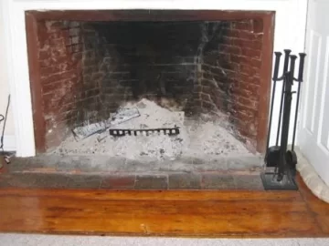

We'll need to have a better picture of the fireplace dimensions before we can recommend a stove. Clearances and flue liner connection are the issues. If you can post a picture that would help us spot other potential concerns too.
Here’s a photo. It’s 27” deep, 27” wide at the back and graduates to 53” at the front, 21” high at the back and graduates to 33” in the front.
