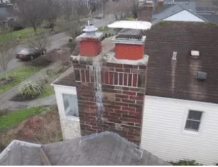

our chimney needs repair (tuckpoint, missing one of the chimney cap). the top of the chimney has a terra cotta top and the concrete that's supposed to hold the terra cotta cap is broken. is this terra cotta top needed with an insert? Our chimney already has a standard chimney cap. would the liner reuse that or would that all need to be ripped out? how do i figure out how much of these chimney repair work i should skip?

  • [Hearth.com] wood stove/insert for 300sq ft
