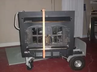

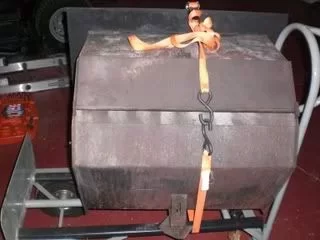

Here are pic's of the proposed insert. See how it just has a flap on the back? I think it might be an old one.

  • [Hearth.com] Wood-Stove insert for my fireplace or Pellet stove for my basement
