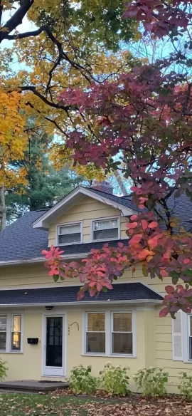

How tall is your chimney?
Not sure the exact height. Our house is two stories tall. Here is a picture where you can see the chimney under the red leaves, above the point of the dormer.

Correct. The flue system looks like it would be around 22' tall.

Good. The height shouldn't be an issue.

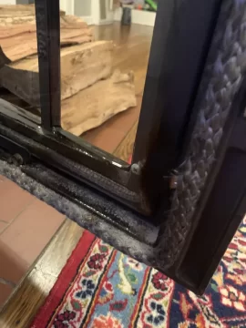

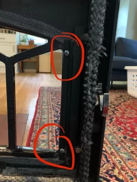

As far as the glass breaking, it was being (incorrectly obviously) installed over the screws that were holding on the decorative grill. So they would replace the glass and it would leave an open air gap. Then I would complain about the air leak and they would try to tighten the glass and it would break. Unfortunately this picture was taken while the glass was broken and waiting to be replaced, but it was finally my dad who said, "You know, the reason your glass keeps breaking is because it is in contact with these screws and the pressure from the screws is too much for the glass." So I'm guessing this is kind of a specialty issue.

It looks like the glass should be installed under that bar and butting up against the screw shank, not over the screw heads.
Yeah tricky, right? On our new door (and I believe how it is supposed to be), the glass is still installed over those screws. I think the problem was that the gasket was previously mistakenly running in the wrong place, so that the screws couldn't screw down tightly enough because the gasket was running under them, so then they stuck out more and then they hit the glass. Now the glass gasket runs more to the side of the screws (instead of behind them) which allows the screws to screw down enough to no longer make contact with the glass. Here is a picture of the new door sealed. You can imagine why it took so long to figure all this out!

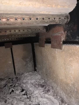

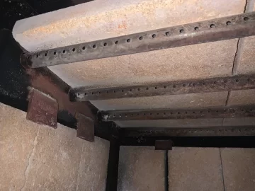

Would these pictures be examples of the "premature steel corrosion" that my owner's manual says can happen due to over firing? My stove is 1 year old, burned from probably October-May, but we definitely didn't burn as much as we would have because we were flying through wood since the fire was so out-of-control with the air leaks. So on nice sunny January days for instance I would just skip the fires. My owner's manual also says that over firing voids the warranty, but in this instance I don't see how I should be the one held responsible. I am the only one this entire time who has mentioned the possibility of over firing and everyone else has said that's not going to be a problem, it won't damage anything. And I've been told to just build bigger, hotter fires. I'm just trying to get ready to make a strong case for a new stove and be ready to advocate for myself because up to this point pretty much the only progress that has been made has been at my initiative, my problem-solving, and my follow-through. So I am a bit nervous about the pushback I will receive and just trying to make my case the best I can.
[Hearth.com] Wood Stove Insert with Air Leaks [Hearth.com] Wood Stove Insert with Air Leaks
This goes back to a question I asked earlier. Part of why I was told to build bigger fires, leave the damper all the way open, max out the fire is because that is what I was told was the only way to get the heat I was expecting. Me looking into these problems was in part precipitated by the lack of heat we were getting. Like we could not imagine how this stove could ever put out enough heat to be the sole source of heat for our house, let alone actually make the room it is in warm and toasty. Is this a completely separate issue than the air leaks? Or is it possible that the air leaks would impact the heating ability of our stove?
