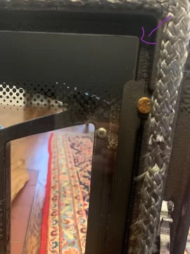

Yeah tricky, right? On our new door (and I believe how it is supposed to be), the glass is still installed over those screws. I think the problem was that the gasket was previously mistakenly running in the wrong place, so that the screws couldn't screw down tightly enough because the gasket was running under them, so then they stuck out more and then they hit the glass. Now the glass gasket runs more to the side of the screws (instead of behind them) which allows the screws to screw down enough to no longer make contact with the glass. Here is a picture of the new door sealed. You can imagine why it took so long to figure all this out!
Hopefully, at some point I will get a chance to see one of these in person. I'll have to take your word for this, but it looks like there is a radius on the corner of the glass and it heads upward right before the screw. Otherwise I agree, running it over a screwhead would make a pressure point.
What is the purpose of this screw and the one above it. I thought it was for the glass clamping bar, but could be totally wrong, never having seen this model Hampton. Covid really reduced my stove shop visits.
I think the screws are what attach the decorative grill? Like the decorative grill somehow screws on to the frame of the door. In this picture you can see the corner of the glass on the top right and the reflection of my hands in the glass.

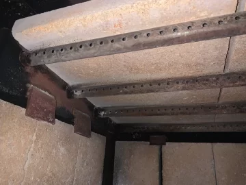

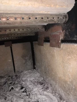

Would these pictures be examples of the "premature steel corrosion" that my owner's manual says can happen due to over firing? My stove is 1 year old, burned from probably October-May, but we definitely didn't burn as much as we would have because we were flying through wood since the fire was so out-of-control with the air leaks. So on nice sunny January days for instance I would just skip the fires. Is the corrosion pictured below normal for 1 year of moderate use during the burn season?
My owner's manual also says that over firing voids the warranty, but in this instance I don't see how I should be the one held responsible. I am the only one this entire time who has mentioned the possibility of over firing and everyone else has said that's not going to be a problem, it won't damage anything. And I've been told to just build bigger, hotter fires. I'm just trying to get ready to make a strong case for a new stove and be ready to advocate for myself because up to this point pretty much the only progress that has been made has been at my initiative, my problem-solving, and my follow-through. So I am a bit nervous about the pushback I will receive and just trying to make my case the best I can.
Thanks, that's much clearer and it shows the glass clamp bolt. I agree with your dad. That's bad design and a problem in the making. It should have at least had a flathead screw countersunk there.
Heat accelerates oxidation. I am not seeing signs of overfiring there.
Yes I think my dad said the same thing about a flathead screw!
