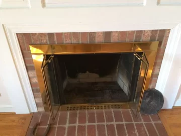

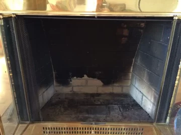

I am thinking my fireplace box is way too small for the stove (looking at yours). I will post measurements. Which kind of makes me doubt my stove installer / chimney sweep, he wants to kind of "cram it" in there....
Ok. Here are the dimensions of the firebox from the fireplace:
front width: 37 inches
back width: 28 inches
depth: 22 inches
height: 39 inches
Attached are the photos. The installer is proposing to take the brass front off and slide the stove in and run the flue vertically into the SS lined chimney. The stove would sit partially inside the box and partially out on the brick.
I think it is not safe but what do I know....
Thanks!
Your fireplace is full brick and masonry, right?
There are lots of fireplaces that are pre-fabricated and put into a combustible chase (sometimes with a stone or brick facade). People tear those out to build an alcove. They need to have lots of space to be an appropriate distance from combustibles.
If your full masonry fireplace has been inspected and clearance to combustibles has been verified, you should be able to install a stove there with an insulated liner going up the chimney if that’s what you really want to do.

Yes. Clearance to combustibles is a literal term. So, answering your previous question about the safety of just sliding it into your current fireplace is dependent on knowing what combustibles are behind and around said fireplace. If it’s a steel box (prefab) in a wood stud closet, then it ain’t gonna work. If it’s an all-masonry structure right down to earth, with no wood framing, then it may work (depending on trim, mantle, etc.). The product manual will clearly outline the required clearances.

Hello, the fireplace is brick all the way up to the roof. The firebox pictured in the photo is just brick/mortar. What worries me is that a) the stove is a tight fit to the firebox and b) since the stove will be sticking half out, there are combustibles above it - I take it I should just tear them out?
My understanding is that even with non-combustibles surrounding the stove there should be some clearances maintained (I think Englander wants 8 inches in the back) and I am not sure if I can provide exactly the 8 inches. Then there is the attached fan in the back - it would be stuck behind the stove in the fireplace and I would have no access to it to replace if it dies, in addition to it not really being able to do its job. Am I correct in thinking this?
