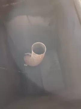

@begreen - thanks for the response. The previous owners left the damper in place and cut through it to install the liner - would this maybe be a good standing for a block-off plate?

If that is a 6" liner then it looks ready to connect. Have it cleaned and inspected first for integrity.
