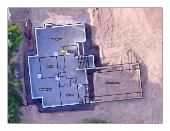

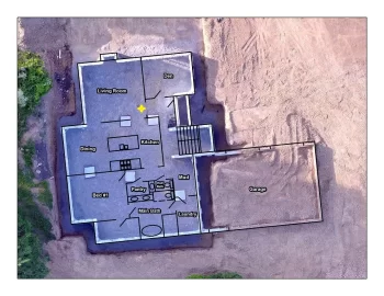

Here's the basic layout of the first and second floors, laid out over an image of the foundation.
First floor:
The chase is on the north side of the living room, you can see the bump-out for it. The openings from the living room to the kitchen and dining area are wide open, no doors, as is the opening to the hallway to the east. The living room has a high, cathedral ceiling. We will have a ceiling fan in that room. The little yellow star indicates where we have an open window in that room to the second floor. To explain, the guy who designed the house for us put what he called a "lounge" on the second floor when you get to the top of the stairs; it had a section that was wide open (with railing) to the first floor overlooking the living room, maybe 5-6' wide. Well it got framed in and then we started debating if we really wanted that. And our builder and HVAC guy were saying it looked nice, but was going to cause problems with heating and cooling. We considered walling it off, but as a compromise, we instead walled it off but left a semi large window in that wall with a wooden door that can be opened and closed for whatever conditions dictate. So, long story short, near the top of that living room cathedral ceiling, we have a wooden door that we can open to allow heat into the second floor.
Second floor:
The little yellow star again indicates where that door to the first floor is located. Dead space just means no floor space. All the dead space to the west of bed #2 and bed #3 is unheated area under roof, some of which is set up for storage, along with the area north of the "lounge" area. The area above the living room is the exception.

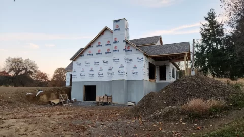

Here's a pic of the chase from the outside:

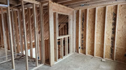

And here's a pic of that small window/door on the second floor that looks down into the living room:
