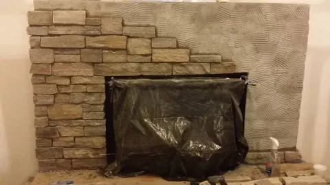

I resurfaced my fireplace brick with a stacked veneer stone. The installation instructions called for Type-S mortar. I also added a liquid bonding agent which was "optional". I bought both at Lowes. [Hearth.com] Wood stove surround[Hearth.com] Wood stove surround

I used a scratch coat over my original fireplace bricks. The scratch coat helps the new brick adhere to the surface. I would say yes. You can see my scratch coat.
I also "buttered" as you say. I used a wet sponge on the back of the stone to wet it first before applying the mortar. It helps so the dry stone won't pull out moisture from the mortar. I also used the bonding agent mixed in the mortar. I used less than a gallon for the entire project.
I was initially going to do a dry stack, but kind of talked myself out of it. It looks like a dry stack, but I didn't want any falling off with all the heat cycles.
