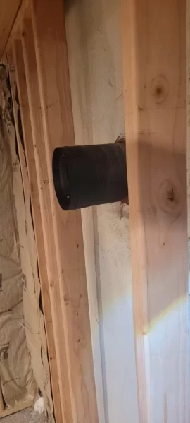

First post. Having some trouble finding info on wall thimbles.

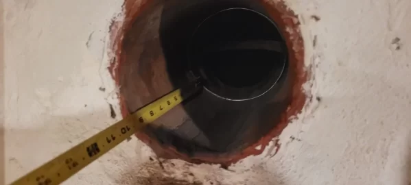

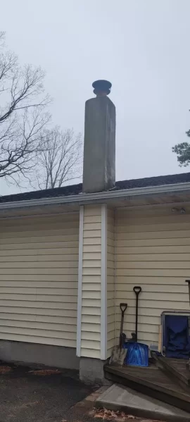

I have an existing jotul wood stove in my currently unfinished basement. It exhausts out of a concrete wall into a concrete chimney lined with a 6" stainless liner. There is a single wall black pipe exiting the wall into basement.
Im currently finishing the basement. The stove area will be wood studs spaced off the concrete wall, covered with cement board and stone.
Im looking a wall thimble to pass through the stud wall to hook up to stove.
The problem im having is the prices of the thimbles. I called numerous local places, they seem to be lost as to what im asking for and are giving all different answers and prices. So far, ive gotten qoutes for $200, $600, and $1000. All three are insulated thimbles. Its just adding to my confusion as to the massive difference in prices. I attached some pictures for clarification if im explaining this wrong.
Any advice?

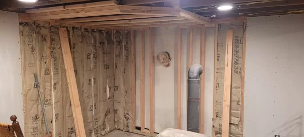

Why not just use steel studs and rockwool insulation?
Yes, there can be a wide variation in insulated thimble prices, but $1000 is a bit ridiculous. The Dalsin Insul-Flue is one option for about $325 (thimble and cover). Heat-Fab makes the Safe-T Thimble for about the same price. The cheapest option might be to frame it in with brick. That would require at least 12" of brick above, below and to the sides of the thimble.
(EDIT: looks like bholler has posted another good alternative)

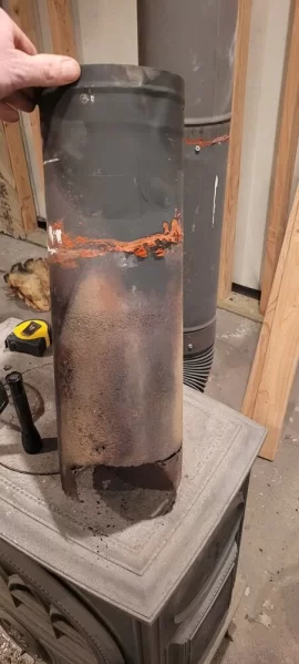

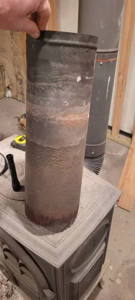

Btw with a stainless liner that should absolutely not be black pipe coming out of the wall it should be stainless
Thanks for replies. This is driving me a little nuts. The whole project on hold because of this thimble.
I thought about steel studs but wasnt sure what kind of horizontal weight they could support. The stone im using is fairly heavy. Wasnt sure if steel would flex with weight of stone attached. Maybe just use steel around stovepipe. Plus, ive been framing with wood my whole life. Im just stubborn.
I was confused about the blackpipe exiting wall too. Its a stainless liner with a tee a bottom(not accessible) and black wall coming in basement. I was told it was fine, but wood stoves are new too me.
I appreciate the replies. Ill look into the thimbles listed. I was once quoted $12000 to skimcoat a kitchen. No thanks, ill do it myself. Welcome to long island

And why would the black pipe leaving stainless be an issue? Is it a corrosion problem?
Yes, corrosion. Once built into the wall is is essentially permanent infrastructure. Black stove pipe can only be used in the room, not through the wall.
Ok. Thanks. Just pulled the black pipe out. It was in bad shape. Can the stainless pipe just slide into tee or does it have to be fastened or clamped?

The stainless tee snout is fastened to the t-body after the liner assembly has been dropped down the chimney. This video shows the process.
It needs to be riveted fast

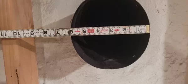

I bought the selkirk one for like $300 and i'm outside the return window. This one from Rockford Chimney supply is a little cheaper at $225. If you end up replacing that T Snout with a stainless one, just order the longer snout (i think Rockford sells one at 22" long), then this thimble bolts to the cement wall, snout runs straight through it into the room, and then i believe you can crimp the end of the snout and screw your black stove pipe to it. someone can correct me if i'm wrong. But this may be a good/affordable way to handle your situation.
(side note - not sure about metal studs supporting the weight of the stone, probably won't, you'd have to look into thicker gauge than what they carry at box stores. But with lumber prices what they are, if you were ever going to dabble with metal studs, now might be the time)

That is an Olympia chimney supply thimble and it is by far the easiest one to work with.
And yes metal studs will absolutely support stone veneer I have done it many times.
