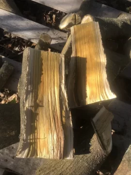

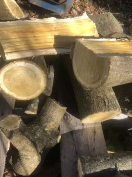

Here is some mulberry I cut yesterday. Does it look like this?
