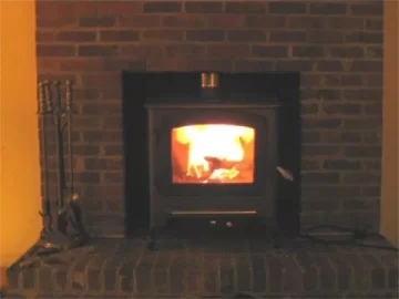

Welcome to the smart minority. Hearth stoves rock. Had an insert for 21 years and won't do it again.
  • [Hearth.com] Wood Stoves for fireplaces

In the smaller house I would really still advise the smaller stove. Gives ya the flexibility that we have. Stoves these days wanna burn one way, hot. With our setup and the one you plan you control the heat in the house with the blower. I always chuckle at the Forum logic here that says that you control the heat by loading the big stove with a smaller load. Efficient combustion starts in a firebox with over 1100 hundred degree temps. Little stove gets there and you only have three hundred or so pounds of stuff tossing heat. The 30 gets to 500 external temp you are gonna get hot around there. Guaranteed. I think we have a unique heat distribution in this house. No fans moving stuff etc. and right now the room the stove is in is just coming up on 79 degrees and the remote thermos in all four bedrooms upstairs are reading 74 with outside temp at 35. 2500 sq foot center hall two story colonial house. Running too hot up there because I was playing with a load this evening. This is all with the blower on the minimum setting which is the lowest I run it. I don't turn it off just because I am concerned that the heat back there might affect it someday. It won't because I can reach behind the stove when it is cranking with the blower off and the housing is cold to the touch because of convection air pulled through it but I am paranoid about it anyway.
You could put the 30 in there without a blower and maybe do alright but not have any flexibility at all. You will have a hot house or crappy burns.
