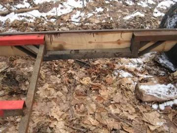

hey guys.... ok, heres my scenario. i have a trailer thats 4x10 , i just got it for 100$ . it was a great deal, it pulled great down the road, nice and straight. its got 215 65 15" tires for a heavy payload and a torsion axle that springs the platform about 3" when i bounce on the trailer itself. i guess there are pluses and minuses with a torsion axle.. i havent used them before.
i see 2 small wires coming from the drum, so im assuming this was a trailer axle with electric brakes? that would be great if they work. anyways, as you can see, the platform is junk, but i wanted you guys to see the design before i took the pics of it ripped off.
i want to haul some wood, hopefully about 3000lbs or less, no more to be safe. the box frame is 2"x2" running in the front and the sides. angle iron is used to brace it left to right. thats about it.
what im concerned about is on the left side of the trailer if you were standing at its front. it looks like the frame had something wrong with it and he repaired it by attaching 3 pieces of 2" box frame to fix it? i dont know much about how to fix cracked trailers, but is this a common method to side the side rails? it almost makes it look like there was a side step of some sort because the frame drops down. .. who knows .
he did however brace it very well as you can see in the pic.
i want to haul the wood safely. im assuming the best idea would be to run 2x10" boars left to right, 50" long, all the way along the trailer. the thing is, how would i secure the boards? i dont think 50 screws into the box frame on the sides would be a good idea! i mean i could just pinch em together tightly and brace them somehow....
after doing this for support, i want to lay the top with 3/4" exterior grade plywood. then i would weld 2x4 pockets to the side so i can build up 2' tall sides, brake light brackets and im ready to go.
the predicament is that i can get one for 200$ without a frame repair like this one has, and with 3x4" outer box frame and sides ready to go. i dont mind spending 100$ on welding material to make it beefier, and 100$ on wood. BUT , is this worth it, or do i just put back on the top wood, and sell it to someone who wants to carry snowmobiles and lighter duty stuff? i know i can get my 100$ back i paid for it because the axle and hubs themselves are worth that.
ugh.. enough typing... what you guys think??? :) click pics to make em bigger

It was a camper in its former life, hence the step.
Looks to me like you have a lot more than $100 - 200 worth of work to make that trailer able to do what you want, and at best it would STILL have less capacity than the one you describe as being able to get for $200. IMHO it's a no-brainer to get the better trailer and sell this one to get your money back out of it...
As to the strange gap in the side rail, I'd be worried about it... Do you have any history on this thing, like what it started out in life as? I could easily be wrong, but it looks like it might have been a travel trailer originally, with that gap being where the door was to get in. If so, I'd be concerned about the strength on the frame, as my understanding is that travel trailers and the like often get a lot of their strength from the bodys that are sitting on them....
If that trailer was all I had, might be worth trying to fix it up, but if you have a cheap upgrade available, thats where I'd be more inclined to spend my money...
Gooserider
If you need a small off-road trailer to pull behind a tractor, I would shorten that up a bit by cutting out the step section and leave it at that. I thing Goose is probably right about going with the other trailer.
The mod on the side's pretty ragged-looking. I'd think you'd want to retrofit some additional steel members across it to support a stout wood floor to get it to the capacity you're after. Needs a lot of work, IMO. I agree with Goose that you just might be better off passing this one along and going for the other one you mentioned. Rick
