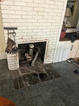

The distance from the side of my fireplace opening to the wood trim on the right is 11" - closer than most wood stove installations are going to allow. Can installing a heat shield to protect the trim be as a simple as an L shaped piece of metal installed into the brick and extending out 2-3" from the floor up several feet?
Most examples I have seen online are for protecting the bottom of a wood mantle - not trim to the side. Thanks!

That trim is flush; it doesn't project past the fireplace flush. I don't think this is an issue. Of course, it depends on the stove. Some have side clearances less than 11".

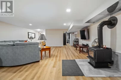

Check out this heat shield on a house for sale in PEI
  • [Hearth.com] Wood trim heat shield
I have some rather large pieces of slate that I cut with a diamond blade and mounted to the wall with bolts and a short standoff. Important to leave an air gap between the wall and heat shield. The black is also good looking.
