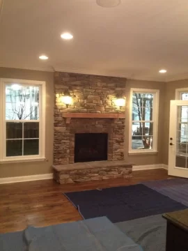

HI everyone, designing my fireplace. I have a ceiling height of 8'3". Width between windows 8 feet. Our firebox is going to be 42" and I'm using 36" for a guesstimate height. I want a raised hearth, maybe 10 inches?? My concern is my mantle. We wanted a custom wood mantle 10-12 inches deep and the height 4 inches. The way I'm figuring is my mantle would have to be approximately 70 inches from the floor if I add the hearth and the box height, plus 24" if I use a 12 inch deep mantle. That sounds ridiculously high and would look stupid in my opinion. Should I lower the hearth or opt for a bluestone mantle? I having a really hard time visualizing this. I really wanted a wood mantel. The images below are my living room and the looks I'm trying to achieve. Help me please!

What kind of fireplace is going in? Will it be masonry or a zero-clearance unit. Will this be for ambience burning or heat + fireview?
The reason I ask is that at least in the second picture, the fireplace appears to be a nice zero-clearance unit. In both pictures the ceiling height appears to be higher than in the proposed location. I think you may need to scale back the fireplace size to the proportion of the space and ceiling height of the room. Take some blue painter's tape and use it to outline some ideas on the wall. Play with it a bit to see what pleases the eye.
Great idea! We were trying to do that yesterday with objects. My husband even recommended going smaller which is so unlike him, lol. I like the tape idea. We are also thinking of going with a stone mantel because of the low ceiling height. We don't want to lose too much of the living room even though it's a decent size. 15x20. I want the stone have a little more depth than the zero clearance pic. We also decided to lower the hearth. I had wanted it a little higher due to his two spine surgeries. I think my brain is trying to find a combo to those two pics but unfortunately I am not one of those people that can envision a project and my ceiling height is hindering me, I can't thank you enough for the help.
