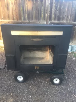

Hey guys new here and I just got a wood chief wood insert for my house and wondering if any one has any info on it I have a lined chimney but here are some pics please let me know what you think it about it.

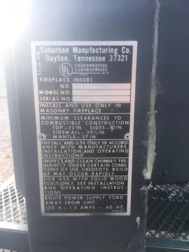

I would suggest Routing the power supply cord away from the unit.
Are there doors for it?
Yes there are locking doors on it with glass windows I had them off cuz I was cleaning them but I mean any concerns I should have I talked to the manufacturer and they did say it was an old unit so I wasn't so sure about it
The power comes from the left side from the blowers how would I move the cord?

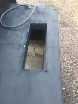

I believe it's 4 inch insert in my chimney but the outlet to the stove is a 12 inch by 4 inch wide
Well you need an 8" liner for that size opening. The liner needs to run from the top of the stove all the way up through the chimney to the top. It should also be insulated for best performance safety and code compliance.
This is my opening you saying I need 8incj for this
Yes 4 x 12 is 48 square inches. An 8" liner is 50 square inches. You might be able to get away with a 7" liner if you have enough height but I would go with 8"
