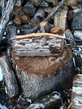

Here is the short log lifter (15 - 18")
[Hearth.com] Woodchuck timberjack and Lockhart firewood grippers

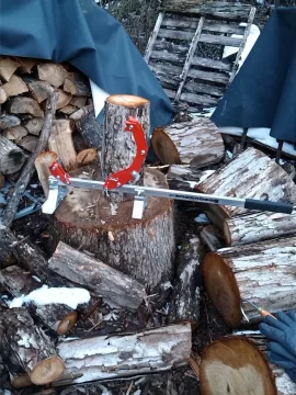

Here is the medium log lifter (18 - 22")
They actually bite into wood quite well (better than I thought they would). If a log is in the range, they bite every time. The pieces I used them on in the pics are from a dead oak tree, very hard..... they will pick it up fine. Used the orange one to grab a 120 lb round off the trailer, and it held the weight. They bite into green wood even better. In the video on Bailey's site, they show someone loading little pieces into their trailer, I wouldn't use them for that. But to pick up larger pieces and put them on the trailer, it works great (you don't have to bend nearly as far to pick up larger pieces).

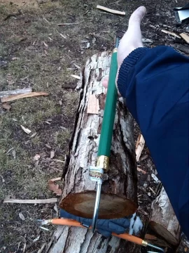

Next is the woodchuck
This is in the log rolling position (with the large jaw on top). [Hearth.com] Woodchuck timberjack and Lockhart firewood grippers
I have used this on some 6 foot long, 18" diameter logs. Rolls them quite well, lots of leverage. That handle is ALL Aluminum, and you don't feel like it is going to give when you are really pulling on it. I have a larger tree on our property that I need to get up (20 - 26" diameter trunk) and I will really test this thing then. I have not used the timberjack feature (where you roll a log onto it). I just cut 3/4 of the way, then roll it over and finish.

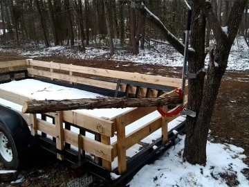

Here it is in the log holder configuration (large jaw on the bottom). This is for if you have limbs that are not cut to size. I had about 20 limbs that I picked up from a tree service, that were cut in 5 - 7ft lengths. Those used to really annoy me because it was so hard to cut them. My old solution was for the wife to hold the log and put it across the side of my trailer. Not any more. This is a 4" diameter log about 6 ft long. The bottom jaw sticks out about 14.5 inches, so my last cut is fairly close to it. It takes some getting used to, as this is a little wobbly, but it beats the heck out of cutting it on the ground.

I scrounge a lot of wood, and often will come upon a tree that has been topped. Lots of stuff between 3" and 6" diameter, cut 6-8 feet long. Quick to load, dries out fast, don't have to split (since I do that by hand). The only reason I hated it was that I had to have someone hold it while I cut it. As you can see from my photo, now I don't.
I've never had a yard tree that happy to see me.
That tree should be happy to see me. After the winter we've had, I considered cutting it down a)for heat and b) because it makes getting to my wood pile difficult.
Good thing for that old dogwood that my wife really loves it.

Absolutely......I cut my firewood 16", but many times I scrounge stuff that tree companies cut to drag out of a yard and get weird sizes. The green one says on their site 15 - 18" and it will actually go a little more than that (more like 14 - 19). The greener the wood (or softer the wood) the smaller under that bottom number you can get away with. I tried them on a dead oak tree, and much below 15 they would slip off. On a green pine tree, it would pick up 14 inch pieces all day.
Buy the size that fits what you cut, and + or - and inch you will be fine.
That woodchuck is a neat tool! I like the impromptu "sawbuck" capability

Hi Smokedragon, I think you might have the log holder configured wrong, I use mine with pin going behind the handle not through one of the holes. You should slide the small red part all the way to the top of the handle so it rests into one of the small notches on the back of the handle.Then use the end of your piece of wood and bump the handle, which will release the claw and it will slide down and hold the wood in position. The reason I noticed is that the end flanges should be holding the end of the wood not the back. It is much more stable and will adjust to different diameters.
