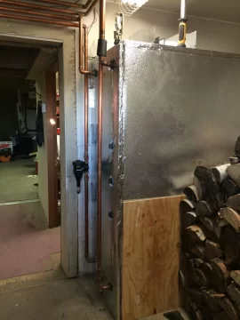

The tank is 2' wide, 6' tall, 4' deep, standing on 1"x4" c channel 4' long. it calculates out to 380 gallons. Paid about $2,700.00, 1/4 inch, with 2"x2" L stock vertical 2 times on each big plate for support, Internally coated, and weighs about 900 lbs..
Made some changes, and going to do some more. couldn't find the fittings I wanted for the upper sensor so I made it, sensor is now dry in the tank 6". Getting rid of the lag I was seeing in the control.
Moved my lower sensor down 1 fitting.
I also took the plate return and moved it to the bottom. Now that I got the temperature logger on it and can see my temperature return from the plate. I can see this is probabley the best spot for the return. I thought I was going to have 1 deg. per inch in height, its more like 1 deg. per 9 inches.
Solar is going to have to be in another tank, I think.
