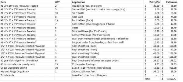

I thought I'd add lumber list if anybody is interested....give a little back to all I've gotten from this site!!!!
Key Dimensions: 14' x 6' (outside posts). Overhang 12/12 pitch and sticks forward 2'. Rear wall 1.5' lower than from wall. 1' overhang on sidewalls and about a 1' on rear.
