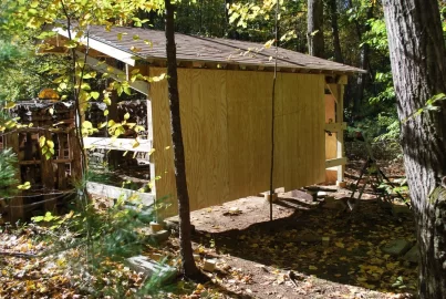

More... I forgot to mention. It is 14' long, 6' deep, 6' high in back, 7.5' high in front. All PT wood except T1-11 and trim.
Roof on, siding going up.[Hearth.com] Finally, I have a Wood Shed!
Just to show shed, it's right behind the drying stacks. I wanted it like this so the load process didn't take long.
Put a few coats of stain on to T1-11

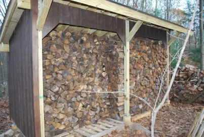

See those footings, I did this because we get some pretty powerfull noreasters here in my parts. The rear of the shed will take the brunt of the winter wind and snow.[Hearth.com] Finally, I have a Wood Shed!
Loaded.
Soon after I loaded, I brought in more to stack in the drying stacks.[Hearth.com] Finally, I have a Wood Shed!
Look like it'll handle a big snow load. Very stout build !
Like the hurricane clamps for the roof trusses & the vertical posts anchored down to the sona tubes.
You'll wonder why it took so long to build a shed now.
Beautiful shed & even more so full of wood ! :)
That is sweet. I am going to go ahead and say I like your shed a hell of a lot more than mine. Wish I would have seen before I made mine. Oh well. Very nice shed.
stejus. Congrats on that build man. Good work and should keep that seasoned wood dry. Have a good burning season.
Too funny about the Hurricane clamps. We had some pretty serious winds with Hurricane Sandy. The shed didn't budge but my fence did!

Great looking shed! How much will it hold?
I did the math on the dimensions and came up with roughly 4.56 cords. The wood I loaded in at was 4 cords and there was still another section to take more so 4.5 cords is about right. The coldest winter with the stove so far was 2010/2011 and I used 4.25 cords and I based the size on that.
