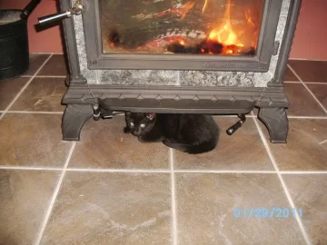

about that picture... I didn't know Hearthstone made cat stoves! :-P
