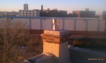

7' of single wall inside and 23' of insulated 6" forever flex SS liner (inside of an original masonry chimney) up to the cap which is 50' off the ground with NW exposure. It is snowing and the wind is whipping right now (14 degrees heading to a low of 5) and I can hear the flue whistling tonight and pulling hard on the stove. I am actually thinking about installing a pipe damper to give me some more control on the hotter burns.

You should not be having a smoke smell issue with a new stove. I'd call Lorin.
I have some concern that you may have overfired your stove. You got your andirons red! Do you have an ashpan? If so, have you had it cracked open at all (on purpose or by mistake) when starting a fire/burning? If you had red andirons, and are now getting a smoke smell, I'd check everything very carefully to make sure you have not overfired and damaged the stove. What else was going on with your stove when he andirons were red?
