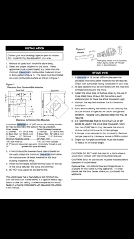

I emailed them and this is the lovely reply I got back from them
  • [Hearth.com] Woodstove clearances and inspections
In other words, no variation from the manual permitted.
