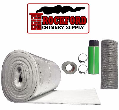

I did find this on ebay... would this work? It says it is Rockford Chimney supply, 15' of insulation w sleeve, clamps, tape, adhesive, etc:
Chimney Liner Insulation Kit for 3 in. to 6 in. Diameter x 15 ft. Liner | eBay
It is strongly advised that you do insulate your stainless steel chimney liner to help increase draft and reduce the amount of creosote accumulation. It's important to check the inside of your flue to make sure you have enough room to accommodate for the insulation.www.ebay.com
Would this work with the Selkirk kit I already ordered?
Sure...but if that is the doublewall (2 ply is a better description) liner, I would cancel or return it if possible...which should be simple enough with Menards, they are very easy to work with...do some research here, those 2 ply liners have issues
