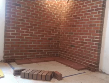

Hi everyone,
I was truly inspired by some of the hearths I have come across here and thought I would share the progress on mine. Still have to build the base but the wall is done. Myself and a friend of mine were able to get this done in a few days’ time, I can’t wait to get this finished in time for the burning season. I'll post a pic once it is completely finished.
[Hearth.com] Working on Brick Hearth - pic
That is looking good! Is there a space between the brick wall and the wall behind it?
Those bricks will store a lot of heat for you.
They will, unless that is uninsulated cement block wall behind it. That stuff sucks heat out of a room like a hoover. Regardless the brickwork looks great.
Yes, hopefully there is an air space between the brick wall and the wall behind, even if it is a basement with uninsulated concrete block walls, that brick wall will store a lot of heat if there is an air space.
If no air space, too late to change it, but, it still looks great!
Thanks for the replies and compliments guys, and yes, there is a 1" air gap between the bricks and the block wall. My plans down the road include insulating the face of the block with foam panels and then drywalling this room.

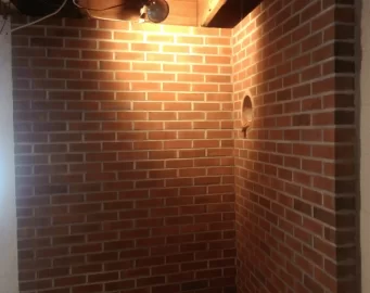

Here are a few more pics after the acid wash and stoning. Really excited to get the base done.

Beautiful job. Where did you learn to lay brick like that? Are you a pro?
I guess it helps a little when your assistant has been a mason for 40 years ;)
My girlfriends grandfather is assisting me with this and he definitely know his trade. I'll pass on the compliments.
That brick wall looks great and, as you know, is a heat bank. Heat that brick wall up and it will give out heat for many hours.
