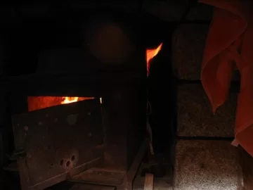

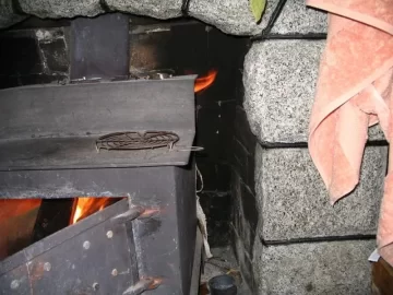

Here's a couple pictures of my worn out, leaky, inefficient old beast (assuming the picture link works) that came with my house when I bought it twelve years ago. Notice the broken door held together with many nuts and bolts, the large gap at the back allowing flames to come out, and the "straight shot" air intake in the door, ideal for sending crackling embers far out onto the living room rug.

Holy crap man! I hope you're intending to replace this before the upcoming burning season. That things a house fire just waiting to happen.
I think you are going to be the winner. If there was a worse stove, the owners are likely dead.

Thats something I would do, I nice 30NC would look nice there. you got balls man
get that thing the heck out of your house man
Scrap the "worst wood stove still in use" award. You need to go after the "Darwin" award. Of course, most of those award winners are dead.

DUH, i bet if the front door wasnt open,the flame wouldnt be jumping out the side & might actually provide secondary air thru that same hole= the stove may have evolved!
Not a chance. That hole is doing nothing but letting cool outside air to enter a smoke dragon (at the top of the firebox, no less). This wouldn't be like adding secondary air to "super heated" tubes expecting it to burn up the smoke. Aint gonna happen.

yeah -spend a $100 on a crappy stove at a minimum. That one is nothing but scrap.
i've seen many non epa stoves which have provision for secondary , adjustable,air intake above fire. current englader wood furnace is one. wonder why?
budism say knowlege is source of ignorance....wonder why?
Yeah, my mistake, that hole in the stove is probably an improvement over the original design. :-/

Since the old rig is setting back inside a huge fireplace; which looks like a handsome/rustic old fireplace by-the-way, it is not as dangerous as it would be otherwise.
If we look at the old rig rather close it appears to either be a home built or a weld shop built stove. Perhaps it was a kit stove that somebody wielded for themselves. That door design was popular in my area in local welding shops back in the late 70's and on.
I agree the stove should be replaced as soon as possible. On the other hand I have to admire how much abuse this old box as withstood. There is no telling how drunk these people were when it was over fired to the point of busting welds and warping plates. I see it as a living testament to how tough welded stoves are.
