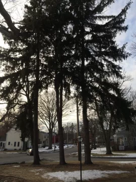

I've got a few large coniferous trees on my property that I need to take down. They run about 80 to 90 ft tall and are 15-25 feet from my house. I live in a pretty tight nit community. If I attempted to take these down myself I would definitely be putting my house in danger and probably two of my neighbors houses as well.
With my tail between my legs I might start shopping around for a tree company to come and fell them for me. Would you guys keep this wood for burning or have them haul it off? I know burning Pine isn't ideal and from the looks of these trees I would have a LOT of it.
Initially I think that hauling any wood off is a waste. At the least I could use it for outdoor fires. On the other hand I don't have all the room in the world for wood storage and frankly storing 3 years worth of hardwood is going to be challenge.

Cut and keep . . . they should season up in a year. Great for shoulder season fires or camp fires.
Looks to be a type of spruce; not the greatest heat output but it's in your yard and it will be good shoulder wood. If you have room for all of it keep it, if not keep some and let the service take the rest. I don't know that you could sell the logs for lumber because they're "yard wood" and mills don't like yard wood. That's because of the chance of hidden nails and the like in the wood can damage equipment and injure employees. There was a day when those trees would have made some nice masts for sailing ships in your area.
Tell your tree guy that you will gladly take several loads of oak/locust/maple etc from his last and future job(s) in exchange for taking away your Norway Spruce. And then pay him to cut the trees down.
Those trees are going to cost a lot more to get on the ground than they are worth as fuel. Use them to gain a long term relationship with a tree service.
I have burned some Norway Spruce and it is pretty nice for quickly heating up the stove and flue. I'd keep it, especially any parts of the trunk that are free of knots. From the pics it looks like there may not be much of the trunk that doesn't have knots, but I'd still keep it.
The large lateral branches of Norway Spruce have smaller branches that hang down vertically, making the branches look sort of shaggy. I can see those vertical branches clearly in the photos. Also, the large cones of Norway Spruce are distinctive, but I don't see any in the photos.
Living in the land of soft woods like I do I would be keeping it but in your post you said you were tight on space. For me that would be the deciding factor. If you need the space for better woods then it might make sense to only keep a portion of it. One other thing to consider is that when you burn soft woods you never have to be three years ahead because it will season in one year or a bit less. I burn Lodgepole Pine and Larch and at the beginning of the season Im sitting on a season and a half of -20% mc wood which works well for me on my smaller lot.

Thanks for your input guys. I'm going to shoot to keep it. I don't know exactly how many coords that is going to tally up to but we will see. As long as its not excessive I think I will be able to make it work. Besides it just means I will need to burn more which is a great problem to have!
