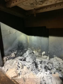

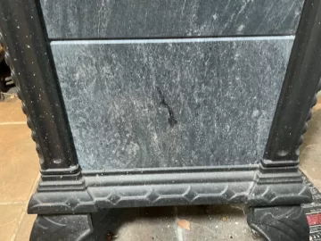

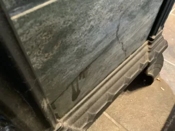

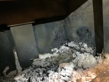

So we did some more research. First we considered poor draft; swept it again & checked the clearance on the chimney cap. All good. Then, with more research, I inspected the baffle as I’d never known it should be replaced. Sure enough, the thing is disintegrating and has two large, irregular holes in it. We were planning to get that replaced & have someone do an inspection overall. Then I read about finding cracks in the soapstone so I looked it over really well. Sure enough, it appears that we have cracks going all the way through the soapstone, & in fact there is creosote leaking out. There are two spots like this, one on either side of the stove; on the inside of the firebox, those two interior areas are also covered in creosote. A third area in the firebox, at the back, has also accumulated creosote but the back stone doesn’t show leakage though there may be a crack there.
So now we wonder if we need to replace much more than the baffle... I read that cracks can be patched with stove cement, but is that true if the crack goes all the way through, AND has creosote coming out? Does that imply a loss of integrity of the firebox wall? And the interior stones? I’ve also read that taking apart a Hearthstone stove to replace those kinds of pieces can be a headache and result in a stove that is never tight enough afterward.

Here are the photos: from left to right, these are the outside right lower stone crack; inside firebox right side & back creosote build-up; outside left lower stone crack; inside firebox left side creosote build-up

Personally I wouldn’t want to spend that much money on a stove that only lasted 13 years. Your small well insulated space could be well suited to a Blaze king. If you like the looks of the soap stone just consider it half appliance half decor and fix it up or get a new one.
In a non attainment where you are not burning 24/7 a good medium small tube stove might be just the ticket. (I’d lean towards BK if 100% wood heat was my plan). Top down fire with a good load a kindling gets a clean burn fast. A jacketed steel stove is what I would be looking at. Plenty out there but not sure what you have available.

Has the baffle been replaced now? Yes, the stove can be rebuilt. Contact Hearthstone to get a service manual, replacement stones, and their cement.
