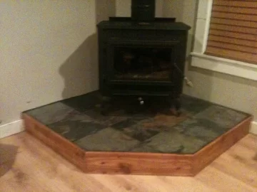

I built this from supplies from Home Depot. Got around 75 bucks in it. [Hearth.com] Would Anyone Have Hearth Pad Recommendations
$75 bucks? You did well.....looks great too.....
Thanks! This was my first attempt at tiling.
30- Slate tile and supplies
25- 3 pieces of Durock 1/2. I made piers under two sheets for the air space I needed.
15- 8' piece of cedar and stain
Screws and scrap 2x4's for outer frame I already had

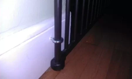

As for the install, this is how I decided to mount mine to the wall/baseboard. It seemed more simple than the included mounting equipment. I am not sure if this will work for you application or not.
