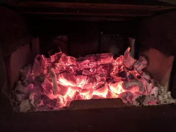

Been burning 5 hours, red hot coals. can barely keep hand next to open door for more than a second. is it time to add a full load for nighttime? or get some more heat from the coals first?
shouldnt i not allow the coals to burn down too much as it will cause the chimney to cool? :p
View attachment 233545 Been burning 5 hours, red hot coals. can barely keep hand next to open door for more than a second. is it time to add a full load for nighttime? or get some more heat from the coals first?
Yes the chimney will cool some as the coals burn down. But that doesnt matter. I would not add wood at that point unless i needed more heat or i was going to bed or to work.
I can usually open the air up a little bit with that many coals, and the stove top will hold 300 for quite a while. That works here unless it's pretty cold and windy out. I would want to get a big load in as late as I could, that way it will still be warm when you get up.

doesnt your house get cold? my house at 78F without burning id wake up at 63 or lower 8 hours later and my house is beyond insulated :eek:
Unless it's real cold or im leaving for work, or going to bed let it burn the way it is.
When the stove is at this coaling stage no creosote is being created. It's ok for the chimney to cool down a bit at this stage.
Reactions: Jotel me this
When coaling you keep the air off correct?
I usually turn it up and burn the coals down. Try and time it so when the coals are burned down it's time to load it up before bed. Takes practice.
I would not reload at this point...it is all about timing.....I run 12 hour intervals with my stove...first thing I do in the morning is crack the air wide open and rake all of the coals forward....20 minutes before I am ready to leave for work what is left of the coals are raked back and spread out and then I reload for the day...this scenario repeats its self when I get in from work.
If it is time for you to go to bed then you could reload on that and feel.good that your stoves up to temperature and is ready to shut down for the night. If your not going to be, then it depends if you need more heat or not. Your past the part of the wood gassing off, so it would be safe to let it burn down some if no additional heat is needed.
Keep in mind that if loading on big bed of coals your wood may ignite much quicker than anticipated, so be on hand to turn it down as needed.
Reactions: Woody Stover
Generally speaking, I would get the coals burned down as much as I could, before I felt it was time the house needed the heat. Timing that to bedtime comes down to practice & getting the right load loaded earlier.
Having coals build up then having to shovel them out to make room for a load of fresh fuel is a situation to try to avoid - that can happen sometimes over time if you don't try to get the coals burned down as much as possible before reloading.
Also, some here will operate differently because they are only supplementing their other heating method, and still let their other heating method fill in the gaps once in a while. As opposed to others who will do whatever they can to avoid say the oil cutting in for the entire winter.
Depends on if you want to go to bed or not. You could wait a bit or load it up for the night and get some sleep. I wouldnt stay up waiting for it to burn down more just to load it back up before bed. Course my stove is super easy to manage, yours might be more finicky.

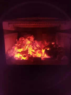

My situation right now. Staying up late to burn down some coals for a reload for bed.
I've been using the stove as primary heat for house since power is out and it's in the garage so been running full rager with new wood every hour.
I'd be tossing in my logs and going to bed, i dont know what you're waiting for there. Thats the perfect reload stage in my opinion.
