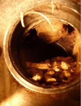

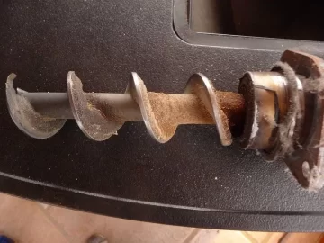

Progress Report: Removed auger and discovered the true state of things !!!!!!!!!!!!
Auger totally plaqued up with a fine past of sawdust and condensed woodsmoke. Second pic is looking down auger tube from back where you can see an even more heinous accumulation of fines & "tar" blocking up the "drop zone" from the hopper. Reason stove shut down - pellets could no longer pass through this thicket of nastiness!

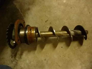

Soaked the auger in warm water & the gunk came right off with a putty knife and stiff pipe cleaner. Here's the auger drying in front of the P61A.

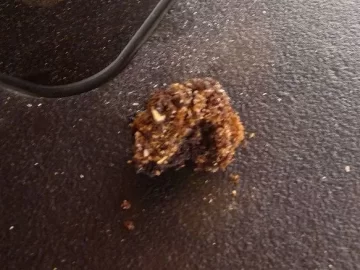

I've been chipping away - more like gooping away - at the stuff up above the auger shaft, mostly using a screw driver. Buildup was predominantly on the fines box side of the chute, since my slide plate was gummed up and not discarding fines anymore. Here's one of the globs of "cookie dough" I pried out.
[Hearth.com] XXV gummy stove gets me
The drop chute isn't totally cleaned, but it's certainly functional again.
