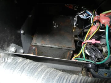

What you thought was the fines box, sounds to me like you are referring to the cover in the front of the burn pot. Good to clean that area too, once in a while. The fines box cover is behind the control board. Next time you have the lower shield off on that side, stick your head under there and look up. It's about a 3"x6" metal cover with a single wing nut holding it on.
