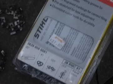

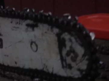

I have been very happy with Stihl RMC full chisel chain on my 029. Mine is a 20" bar so you should have even better results with your 18". Here's a picture of the box and another to give you an idea of what the chain looks like. This is not "safety" chain so you do have a higher risk of kick back when using it.

The picture of the chain sucks. Sorry. I will look for a better one.
Also look around this site. I think it will answer most of your questions. I learned most of what I know reading here a few years ago. (broken link removed to http://www.madsens1.com/muu_barchain.htm)
When you do buy, I recommend Stihl chain.
That's yellow label semi-chisel chain, not full chisel. RSC chain is full chisel. Been meaning to pick up a couple RMC loops for my 034.
Green label chain is "low-kickback", "homeowner", or "safety chain".

Oops! I guess I should pay more attention to what I buy. :red: It still cuts very nicely and the 029 seems happy with it.
