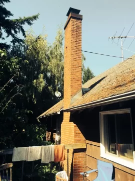

So I'm renting this house and it is from the 1930s and it was this ENORMOUS fireplace. I'll include a picture, but it seriously takes up the entire wall. It's an exterior wall. The chimney goes really high up into the air outside, without going through any more stories, and it has a cap thing on top, I assume to keep birds and rain out? It is anchored to the roof with a thick cable.Inside the fireplace itself is a very gross, rusted out metal insert thing which I believe, based on my Googling, is a Heatilator or similar. This theory is supported by the presence of some intentionally missing bricks along the floor line, and some up above, I assume these were the "in" and "out" vents for the airflow which was supposed to go behind and around the firebox?

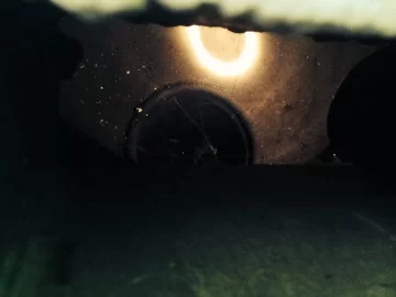

Since the top of the firebox and the damper and all the upper mechanism is rusted all to hell, I'm guessing that smoke/C02 can also come out of those vents now. There is some soot on the bricks above the vents to support this theory. Inside the fireplace, there is the old rusted lever which originally controlled the damper and now isn't even really attached to anything, it's just hanging there. There is also a long steel cord, and a place to anchor the cord. I believe this controls a SECONDARY damper, one that was installed possibly to compensate for the original one being rusted through? When I pull it, I can hear a "ch-chunk!" noise from way up in the top of the chimney, and the same when I let it go, so I think this secondary damper is working just fine.

Greetings. I added some paragraph spacing, not sure why you could not. Getting a certified set of eyes on the fireplace is a good idea. We can't assess its condition remotely. The second damper is likely at the chimney top and must be open or smoke will back up, Likewise the lower damper must be open.
If the sweep finds that the heatilator is rusted out and some of the exchange tubes are compromised then one option would be installing an insert with a full stainless liner. This would cost about $1500-2000 with a self install. A freestanding stove could be put on the hearth, but it would need to be rear-exit which means a cast iron stove.

thanks for responding and also thanks for fixing my paragraph spacing! i don't know why i can't add in paragraph spacing, either. i'm using a macbook, idk if that is relevant. okay, so what we know so far is that upper damper works, and the bottom damper doesn't work but is stuck in the open position. and that fixing it would be expensive. :) thank you!

Getting a chimney sweep to clean and look at what you have would be the first step. From there you can find out your options.

I second the fact that the upper "damper" is what you have with the cable/chain thing. These are metal flaps that close off the top of the chimney when the chimney is not in use. Keep if full open when in use. Obviously, you don't want to close it off until the coals have all burned out and no CO is being generated any more. They keep rain and animals out of the chimney when closed.
Since you are renting, I would be leery of putting more than a little money into this project. You are already probably leery of this yourselves. Unless you decide to buy a stove that you would plan to take with you when you leave or when the owner kicks you out to level the house. This is what I did way back when: bought a stove and took it when I left. Before you do too much planning on that, though, you need to determine whether the existing chimney/stove pipe will be easily [and not too expensively] connectable to a different stove. Adding different stovepipe and stovepipe parts can exceed the cost of a stove itself.
But you are right to want to check this thing out. You do not want to use it until someone can look the entire system over from the chimney top to the insert and give you a report. It might be useable with a few hundred dollars worth of parts and labor. But it might be completely shot. Repairing the damper might be something as simple as re-attaching the handle to the damper with a bolt and nut. Or, part of the damper may have been rusted and then broken off. Even then, it might be a small welding job.
My money is on the fact that the upper damper is there because the lower one doesn't work.
