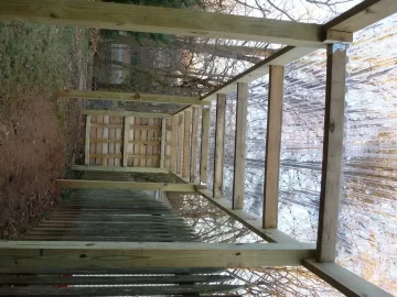

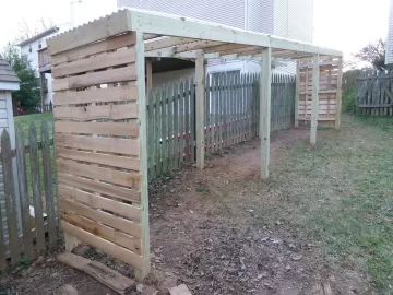

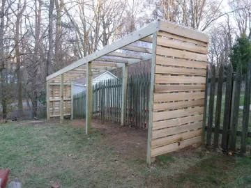

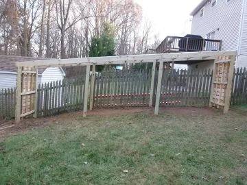

I've got about 3-4 cords of covered space under decks and such, but for the rest of my wood I've tried stacks with and without tarps in various places in my yard. Finally got sick of shredded tarps and uncovered stacks that rot and never dry, so I decided to put a roof over a previous stack location. I went pretty minimalist, 4x4 posts and PT 2x4 and 2x6 for the structure. Biggest cost items were the 8'x26" polycarbonate roof panels at $20 each, really wasn't a cheaper option that I trusted (PVC sounded iffy) and they were easy to install. Bonus is that the sun will still get to the wood. The siding on the ends is some tulip poplar I milled a while ago and was just cluttering up the yard anyway. I had to keep it fairly narrow due to limited space; it's 24' x 4' by roughly 6.5' high. I'll stack on pallets about 6' high, so it will hold roughly 4 cords if I pack it tight.
Obviously with the minimal overhang front and back the log ends will get wet now and then, but the main thing was to keep water from getting into the interior where it never seemed to dry out.

Looks good to me, only problem I see is I'm thinking that because of the minimal slope you'll get water running back under the end of the polycarb roofing on the low end and running down the side fascia and side wall of the woodshed.
I've never found sideways blowing snow or rain to be a problem. I'm guessing you'll be able to get around 6 cord or more in there.
Is there any pitch to the roof? <Edit>: it looks like it slopes the long way with the back yard.

Yes, it slopes with the back yard, which is surprisingly hard to judge in the photos. The yard has enough slope that I pretty much had to follow it anyway, and since the panels are corrugated it wouldn't have helped any to slope it along the other axis. It's not a super steep slope as roofs go, somewhere between 1/12 and 2/12, but enough to shed rain fine without any apparent leaking. (There's about 2" of overlap between panels.) We'll see how it deals with snow the next time we get a real storm, which happens every few years or so. I might have to clear it off if it sags too badly.
