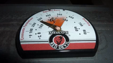

I love your max temperature pointer Woody. Creativity at its best.
Reactions: Woody Stover
I'm not that smart; I merely stand on the shoulders of giants here at hearth.com. >>

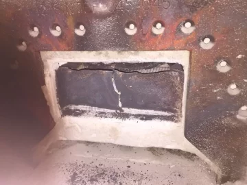

Do note, my stovetop temp was holding 450F, while the cat was going nuclear, at 2000+ F. I believe this rules out things like door gasket leaks.
Preliminary pics, showing cat completely disintegrated:

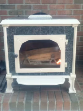

A few years ago we had a serious windstorm which resulted in a draft-induced overfire in our Firelight 12. Ours is green enamel and not only was the stove glowing at the chamber behind the cat, it also bubbled the porcelain on both sides of the chamber. After that, we installed an inline draft damper which we use whenever we have high winds.
