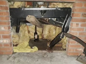

Still waiting for some pictures of the current state of the fireplace.
Apologies i'm currently not at the house, i only have one picture of when we worked on getting it out. We didn't want to take the siding off the rear of the unit to remove the fireplace nor did we want to remove the brick in the front to remove it so we ended up cutting it out. The added picture shows the state before removing the very top and chimney pipe... the house had a chimney leak for quite some time that went unnoticed by the previous owner(s) thus the fireplace was rusted out but the wood is still in good shape. But it might give you an idea.

  • [Hearth.com] Zero clearence pellet stove chimney options
Next time there please get us a pic. And hopefully after you pull the fiberglass out we will see bricks. Not framing wood.
This pellet insert install is throwing us wood burners off big time, the pellet insert allows for a "built-in" install, essentially you can take an existing clothing closet, build a hearth using 8" hollow concrete blocks and as long as you keep the clearances listed in the manual, your good to go.
