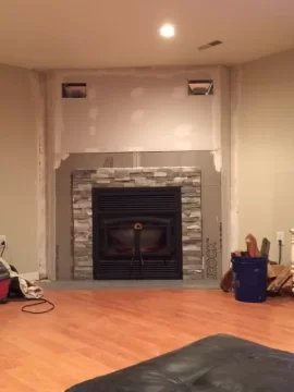

Hello, here is my 2 cents about this. I installed a zc in march of this year. Yes it is true that you do not get the same amount of heat if the power goes out because the zc is closed in. But I installed a gravity kit on my unit that allows the trapped heat to escape the fireplace with out the fan on. Many days I don't turn the fans on at all. I also installed a forced air kit with insulated duct to the upstairs of my house to spread the heat. I am still finishing the install but here are some pics. The 2 vents are the gravity kit.
