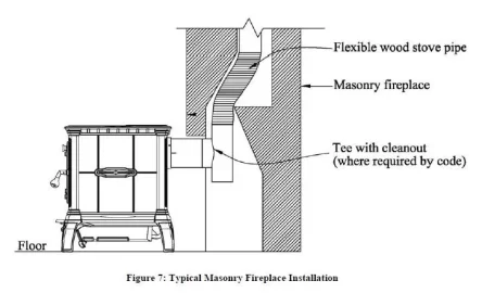

Nater said:
I started looking at new woodstoves last week and my top two choices were the Alderlea T6 and the Jotul F600. Both are too tall and won't fit inside my fireplace. I looked at the Jotul Oslo and it looks like it will fit (and has an available short leg kit) but I was hoping to get a bigger stove as my house is about 2500-3000 square feet. There didn't look to be any others at the store, except real small ones, which would fit.
What other stoves are less than 28 1/2 inches high and have a larger firebox?

mhrischuk said:
The Hearthstone Equinox is rated at 120,000 btu and 3500 sf. The rear exit looks like it will go under your 28" no problem.
But it needs an 8" liner. And the wife doesn't like the look of stone. :) It was one that I looked at, until I saw the 8" inch flue. I can only use a 6" liner.
Would the Morso 3610 work?
Looked up the rear ehaust height and it looks like it's 26 1/8" on center. Maybe you should look into modifing the fireplace opening for a little more height to give you more options. Give a local mason a call and see what they can do.

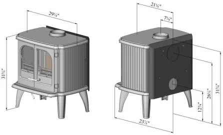

Looks like it would be a little too tall, even with the rear vent it would be a little over 29".
