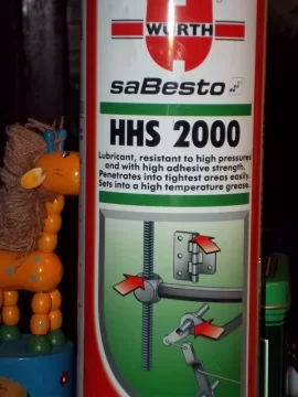

  3. ewdudley Minister of Fire

  4. Roadstar Member

    Grease, adhesive?
    Thanks, I'll pass.

    Ignorance is its own punishment.

    Most greases have adhesive and cohesive properties. Cohesive so they stick to themselves, and adhesive so they stick to the thing they're protecting.
    Most cartridge bearings come pre packed with "grease" that at best, is Vaseline. Any hi-temp wheel bearing grease would be better than that stuff, and its quite easy to pull the seals (I use xacto) and repack them 1/3 to 2/3 full. If you can find one with "moly" even better, as this will add an extra layer of pro incase the grease deteriorates.
    FWIW, even the lowest rated hi temp greases are good to about 375 degrees. Not likely you're hitting that.
