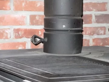

    I had one burn get away on me when I stuffed in too much pallet wood. After that I resolved no matter what people say I would go no longer without a damper in place. Luckily since it's installation I have never had to try it out. IMG_0043.JPG
    Jack768 and raybonz like this.
