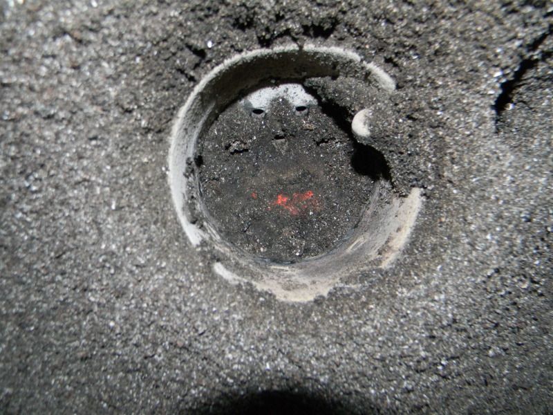

    My issues continue. I had the dealer here twice and they are about as useful as lead shoes wile swimming. Flame is big, stove is clean. Pulled the stove pipe off on Sunday and cleaned it. I have had to clean out about 1.5" of ash from the bottom of the horizontal pipe leaving the house every week. Ash in the stove is ridiculous. Build up in the pot has to be dumped every day. This is the pot after 24 hours of operation on the high setting. Feed gate is as closed as I can get it and has been for the last 3 weeks. It's the only way it will run on high. All my air pathways are clean and I cleaned the fins of the exhaust impeller. There are no air leaks.
    [IMG]
    I am beginning to think I have crap pellets. My dad has a quad and he runs the same pellets and he has noticed a lot more ash in his stove and horizontal pipe than last year. I used these pellets last year and could go through an entire ton before I even checked the stove pipe. There was very little inside after one ton last year. I am going to buy 10 bags of different pellets this Sunday and see what it does next week. With the feed gate closed down this stove will not heat my house when it goes below zero. It was -19 last night and when I woke up this morning the house was 62 degrees an it should have been 71. It kept the house at 72 degrees last winter when we saw -27 outside with a 30mph wind.

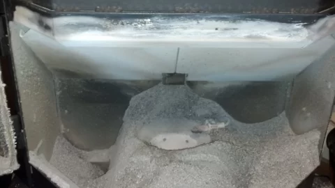

    My pot over 2 weeks of burning.
    Your ash looks really dark. Which is still indicative of low air flow (incomplete combustion)
    And i haven't cleaned anything in almost 50 bags. I pull the clean out about every 10 bags.or about 2 weeks.
    Mine is a Quad, but they utilize the same parts (basically, but my unit is bigger. Yours is the equivalent of a Santa Fe).

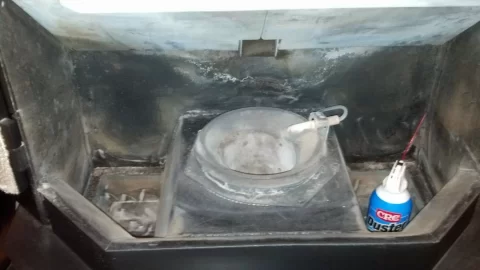

    Also attached a pic after cleaning. To show how deep and how long since season started.
