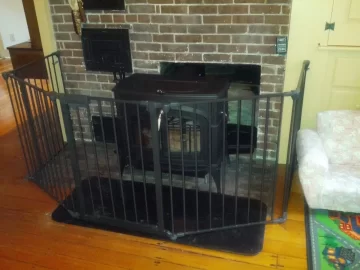

Hi everyone- long time lurker first time poster.
This will be my second full season as a wood burner and I love our Clydesdale which i bought after sifting through the loads of valuable info on this forum.
Our big concern this year is avoiding any accidents with our child. She's already shown interest in the knob/handle of the insert and I'm afraid that when we start burning soon she's just going to get more curious.
The insert sits about 14" up off of the HW floor. Is there any kind of protective screen that can be recommended?
Any general advice on keeping a child safe with or without some kind of barrier??
We got a Kidco hearth gate second hand on Craigslist. Works great and you can buy extra sections to vary the length.

We have the kidco hearthgate. Its pretty invasive in room and not fantastically attractive, but I have two clumsy young boys. This thing is sturdy. It allows us serious peace of mind. While I'm at work my wife can leave the room without having to lock the kids in their rooms, or bring them with her everywhere she goes in the house. Our insert is in the living room where we spend most of our time. Added bonus: we hang our wet clothes on it when we come in from the snow. Its a perfect drying rack.
Our biggest concern wasn't really the kids touching the insert, but more the fear of the kids falling into it while bouncing around like lunatics.
I was in the no gate camp, wife was in the gate camp, wife is smarter than me so we have a Kidco gate. :) I agree it's pretty easy to teach "hot", it's more difficult to avoid clumsy accidents from happening. My stove is in my family room(ie play room) where we spend most our time and it's not a large room so the gate provides some level of security against the accidental fall, toy getting tossed into the stove etc........
