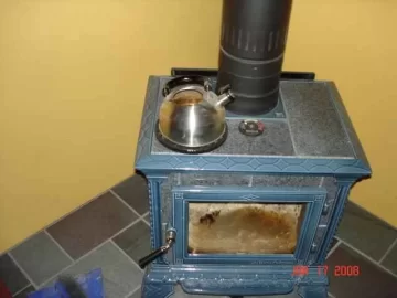

heres what i use.. seems to work well... i heard that if its right on the stone that it may scratch and even stain the stone with rust.. i wasn't taken any chances... this was ceap and easy..
  • [Hearth.com] Kettle on a soapstone
