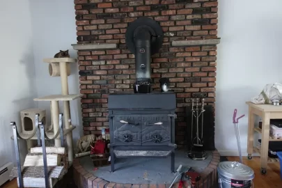

Hi, I am new here. I recently moved into this house which was built in 1971, Hudson Valley area of New York. I am looking to replace this stove with something more efficient. I noticed that the exterior 8" double wall chimney seems too close to the roof fascia before it gets above the roof line. The pipe has no labeling and looks to be original. Would it be best to replace everything and start over, it also seems that most stoves recommend a 6" chimney flue now. Any advice is greatly appreciated.
I had 2 professionals come out and look, one wanted to hook up a new stove directly to the setup with a reducer and the second wanted to replace everything.

If the chimney has been in service on the Timberline for 3 or 4 decades it may be time to replace, especially if there have been some chimney fires.

Pick a stove before you get the flue replaced.
Some big stoves still need 8".
What are your heating needs?
You don't want is to get a new 6" chimney installed, and then decide that you want to heat a poorly insulated 3000sf with wood only...

If you look at the pictures I posted do you think it's unsafe to use the chimney until I get it replaced in December? I think I have less than an inch between the roof fascia and the pipe.

DuraPlus is DuraTech's economy chimney. I would put in DuraTech if the budget will cover it. It's a better chimney pipe.
