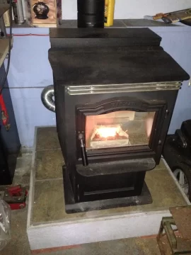

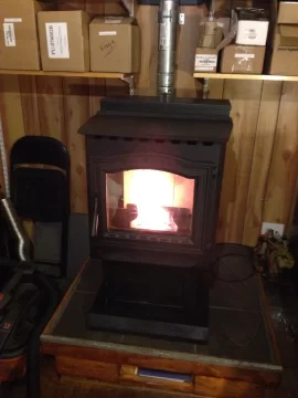

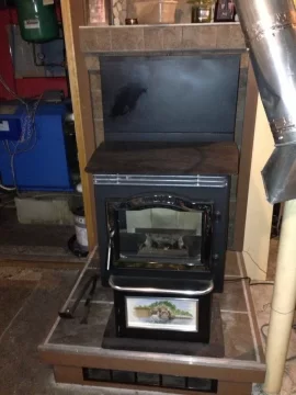

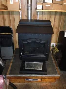

You still did very well! You cannot go wrong with a Harmy!
I have 2 P61s that I updated to P61a-2. You can always do that in your leisure. Welcome to the Pellet Pig Harmy Club!
I hope you don't get hooked on buying them like I did!
I bought 4 so far, but I sold 2 and they paid for the other 2! LOL
See!
