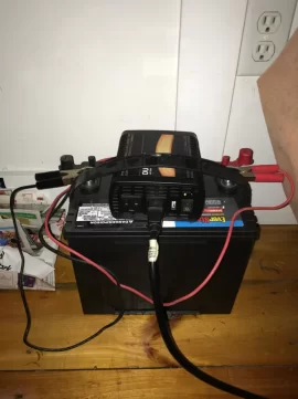

I used this to keep my family warm during 3 back to back to back power outages from nor’easters. We lost power for 76 hours and then 15 hours during storms 2 and 3. I used the outlet on my Tacoma a few tones too while charging phones etc. outside
Set up is a Duracell power inverter. ~$70 and a deep cycle marine battery. Worked very well turning on and off to keep the main room in the low to mid 70s.

What did you power with it?
